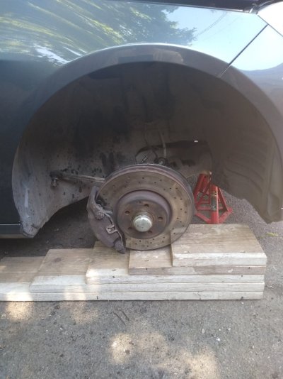

Just waiting on blasted parts now and coil spring compressor.
Bloody front center jack point abliterated first thing when raising the car luckily I had my car on the ramps, as it's so low I can't get the small trolley jack under. I'll need to get a new front jack mold. eBay I imagine?
Or Autodoc perhaps? Amazon has nice jack molds that fit the Mercedes jack points perfectly.
But it's stuff like that that take a big job and makes it huge. I had a Volvo come off the stands. Punched the fuel lines in two.

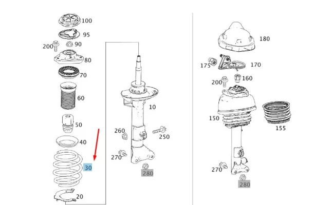

I highly recommend changing the shocks, upper mount with bearing and at least a new damper. I'm guessing your original lower seats are rubber. The new lower spring seats from Mercedes are steel and rubber. I you compare a new fully assembled strut to the old one, you will notice the upper mount is much more stiff. You have taken it all apart already. Renovate it completely. The driving feel will probably be a very positive shock. OEM Mercedes shocks can go 500K kilometers. That doesn't mean the performance hasn't vastly degraded. OEM are either Bilsteins or Sachs. Neither will disappoint you. Some people take pride in changing for a new car every 3 or 4 years. Some take pride in maintaining a vehicle like new for 20 to 30 years. I'm the latter. I did put in Carplay. 580 euro for Becker updates that are outdated the following day are worthless.
If I was to buy new shocks absorbers they come with a bottom spring seat on some units?
Are all top mounts interchangeable for the correct vehicle/strut assembly?

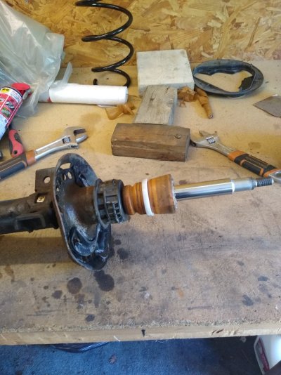

The top mount and bearing kit I used are Bilstein 12-305612. The shock was Bilstein 22-194091. The mount and bearing will fit any shock that fits the S212. While many cars have the spring sitting directly on the integrated shock spring cup, Mercedes uses an additional thin seat that acts both as a spring end stop and a noise control buffer. You will probably only find it at your dealer. The plastic piece that you should have found on top of your shock mount can be washed and reused. They don't show wear. The mount is not metal to metal. Again, another bit for noise control.
When I see the photo of your old shock, you have the plastic top piece and the bottom seat. Take that shock apart and give the bottom rubber seat a good scrubbing with liquid dish soap. If it's not cracked you can easily reuse it too. And piece 40 may also be reusable. That's another I had to source from Mercedes. At Mercedes I bought the bellows, dampers, seats, and top ring. 200 Euro. That's a lot for a few pieces of rubber. But they do have a star printed on them. :) I reused nothing but the bolts after a wire brushing.

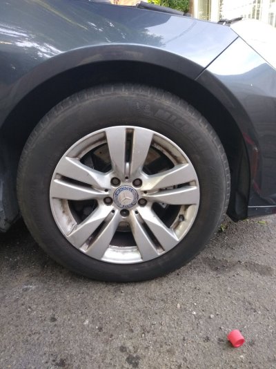

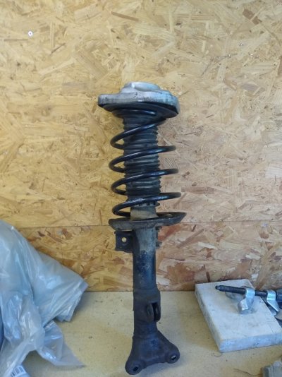

Drivers side done, passenger one on the bench ready for surgery. Jesus sweept, getting the holding down bolt/plate isnt easy, as them poxy spring compressors don't compress the spring enough. I'm getting there. 👍
