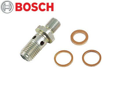

Is it possible that fuel accumulator or non return valve on fuel pump sometime hold the pressure for days sometime not.
Marjanov This is the - View attachment 99178Check valve
When I put ignition on l can hear pump for few seconds when it stops l turn the key to start the engine.Also l left engine running and check pump under the car it is fine and quiet.
Non return valve is not expensive l will change it first.
