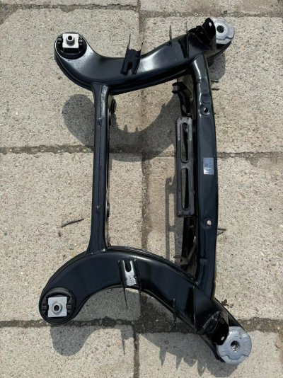

I went for a wheel alignment on Monday (w212 2011 E220 CDI), and found my rear subframe had corroded. Dropped the car off at Merc this morning, got a call this afternoon saying that all would be covered by MB. The chap at MB said that they are getting alot of these with W212`s and also on W204 models which MB do replace as good will (I believe the car has to be in decent condition), mine only has 55k miles. I had minimal issues, a slight pull on the steering (hence going for a wheel alignment) and it felt a little lose at the back end but nothing too bad. The steering only started pulling last week so I was lucky I took it for an alignment when I did.. MB dealer was really good - but 3 - 4 week wait for the parts to come in and for the work to be done..So this is the rear subframe currently on my 2013 W212 (90'000 miles). Currently with MB being replaced under 'good will'.
I'm just curious who else has the same issue and how prevalent it is?
Car was pulling heavily to the left under hard braking which I why I got it checked out.
Oh dear!So this is the rear subframe currently on my 2013 W212 (90'000 miles). Currently with MB being replaced under 'good will'.
