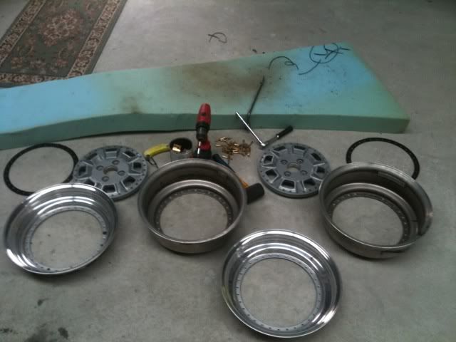

Tires are Kumho Ecsta XS..front 245/40/17, rear 295/35/17.
Aka$h supplied a great set of wheels and modified the rear offsets for the widebody stance.
( Front wheels in the latest pix are an old set of Borbet Type A which were used during painting. )
Ed A.
But it still doesnt answer a question, do you shave down the hub part of the wheel
Just as "MaxMatt' posted......
Aka$h ( Simal ) can better explain how the combination of lips, barrels and center sections can alter the offset by moving the center section to the front or to the rear of the centerline of the wheel.
If you look closely at the wheel you'll see a ring of small special head socket bolts that hold the wheel together...remove these and the wheel is in it's component pieces.
Using a wider wheel without altering the stock offset will create interference problems with the suspension and/or sheet metal.
Below is a pic ( not the AMG wheel ) of the component parts of a multi piece wheel.
