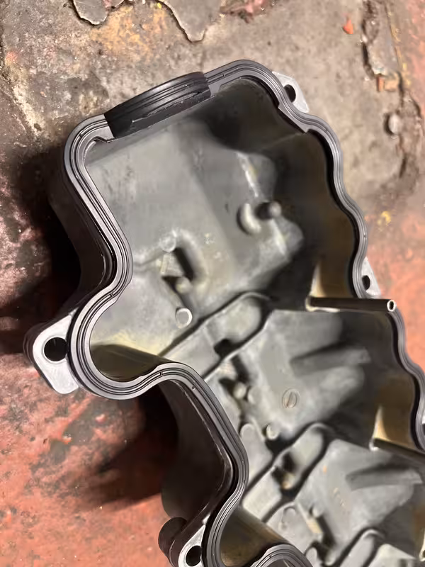

Another update for the C55,
When I inspected the car, I noticed that the oil breathers had possibly been off before as it looked like someone got a bit too excited while applying the silicon!
The oil breather pipes felt a bit hard as well, not perished but as I was going to get oil breathers sorted, I thought I might as well change the hoses.
I also ordered the rocker cover gaskets from Mercedes.
While I was getting these parts at the dealer, I also ordered the spark plugs from them. I’m sure I paid less for 24 plugs that the S65 takes!
Anyways, because the car has done 50k miles, I thought there is a possibility that the plugs have never been changed and while I’m getting all these work done, just get the spark plugs done at the same time.
I got all the filters and engine oil from Mercedes too and yesterday I thought it was the day I would tackle all these jobs.
Taking the rocker covers off wasn’t bad at all. What took a lot of my time, was getting the silicon off the oil breathers! I spent ages making sure it was as clean as possible before applying new silicon.
I was so impressed how clean and fresh the engine looked inside! The cleanest engine I have seen so far!
No wear at all on the chain.
The gap on the spark plugs still looked good but I wasn’t going to put the old ones back on as @Petrol Pete mentioned that Mercedes removes them for inspection but if they still look good, they’d put them back! 😳
I carried on with removing the silicon, changing the spark plugs while the rocker covers were off and after many hours, the car was all done.
Here are some photos,
As I said, it’s not a difficult job to do, just time consuming.
Old vs new spark plugs
One clean engine!
Just a tiny but if silicon removed from the drivers side oil breather 🤦🏻‍♂️ ( what a mess! )
The spark plugs were torqued to 24NM if I remember correct now
The new gaskets, oil breathe pipes and plugs.
Nice and clean
Nearly done
The rocker cover bolts were torqued to 9NM as it said on technical data
All back together!
The old rocker cover gaskets didn’t feel hard but as I’ve read they tend to fail, I thought it was a good time to change them.
New air filters
I didn’t changed the engine oil yet as I thought I’d do that once the silicon is dry and I could run the engine for a bit and warm up the oil before I drain it. Car has only done about 50 miles since I last changed the oil but Mr OCD tends to do these when first buying a car and use the first oil change as an engine flush :D

Did you fit new bolts? I seem to recall they are single use on the breather, not sure if the main cam cover bolts are single use.
Hi,
Yes I did fit new bolts. You are right, they’re meant to be single use whereas the cam cover bolts can be used again.
I go into so much detail when I post, yet I forgot this part :D
