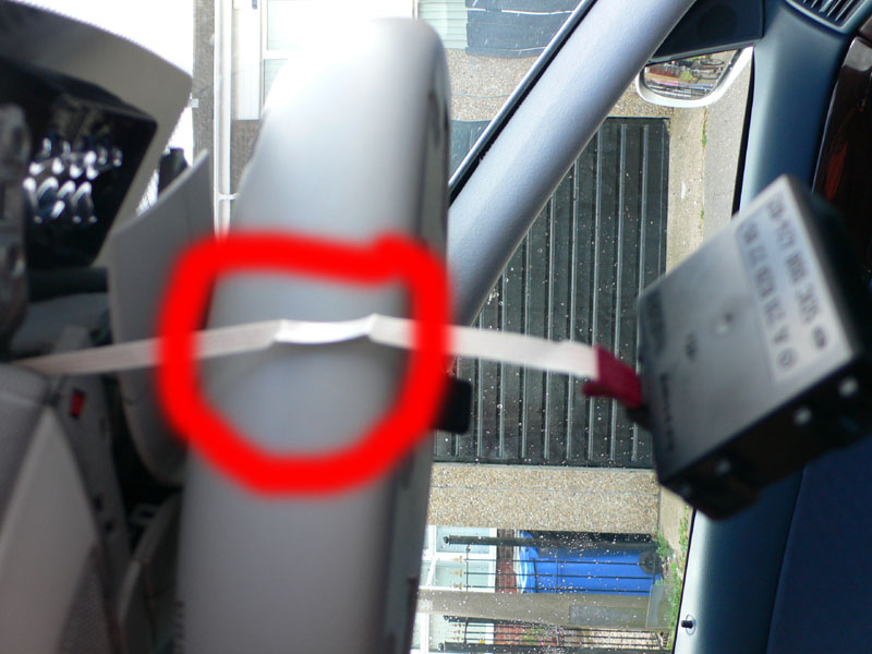

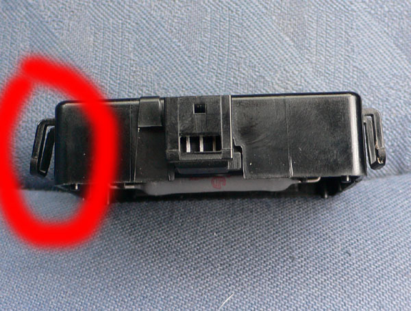

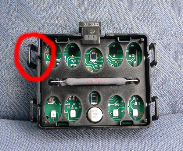

Rained today for first time since new screen put in, no wipers. Great. Last time they didn't clip the sensor back properly, this time not only have they not clipped it in, the sensor clips are bent and the cable kinked.
Anyone else had this problem?? I think in future I can see me insisting on a main dealer fitted screen.
