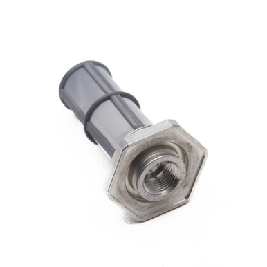

Problem W124 M103 .Will only run if pumps are primed .And stpps
Will .Sorry i would not know. I cant get under the dam thing now to old . But manual shows the hose screwed in to it . But i will check that point for sure /
Your both correct, I've given you a link to the wagon version. :doh:
Try this one, ebay item number: 165122270868
As Will said you can normally wash them out if they are filthy, but if it was causing a problem you would have bogging down under full throttle.
carat 3.6 Sent a message to that Ebay seller that you gave me the Ebay item nomber to in Germany ...jut a waiting game now.Thank you for your help.
This is what i had after i did a compatibility check on Ebay for the part number

If you suspect the strainer is the problem you can wash them out, they only really need to be replaced if the threads are damaged.
Thats the only thing i can do ..still i have the feeling that there must be an equivelent dont you ?
