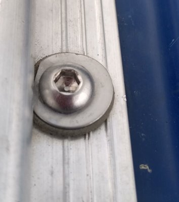

No problem, I knew someone would eventually appreciate my post, word of advice, because your retro fitting these I would not trust the sealing ring to the roof on the nut, I use Puraflux 40 from Screwfix (it's brilliant stuff, use it for many things) I brought Allen key stainless bolts of eBay to attach Keder rail and then used roofing stitcher bolt washers to seal, but still put Puraflux on thread and where the two meet the roof
