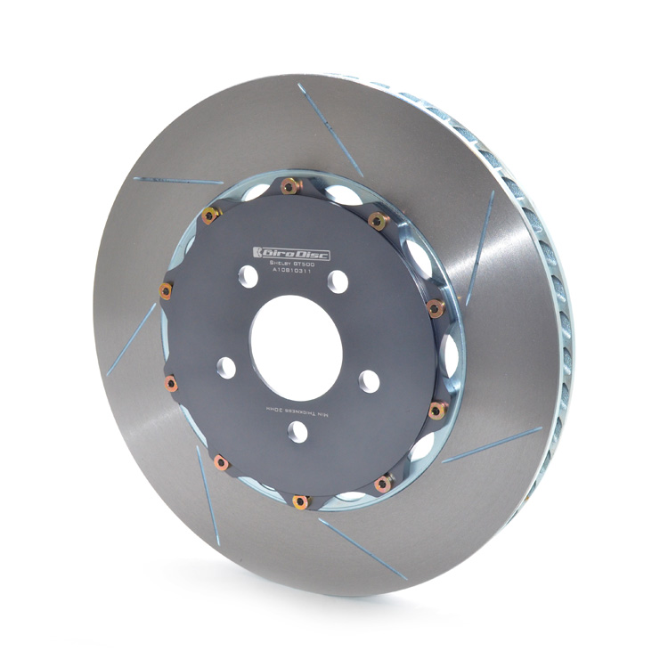

Not necessarily S. Heat conductivity of aluminium is higher than that of steel however the contact patch of a multi piece disc is not the same as that of a solid cast disc. So for heat to dissipate faster, a) the bell has to be made out of aluminium and b) it has to be of a particular design.
Here are the examples of better and poorer disc design respectively to illustrate the point:
