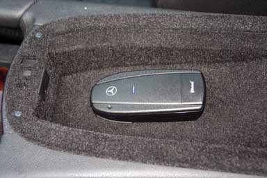

Morning all,
I've fitted the MB4 adapter to my CLK (with COMAND) which functions very well, except for the fact that callers complain of an echo all the time on the line.
Adjusting the volume on the adapter and the incar system doesn't seem to do much.
Any suggestions as to what can be done to solve it? (Before I go to Viseeo...)
