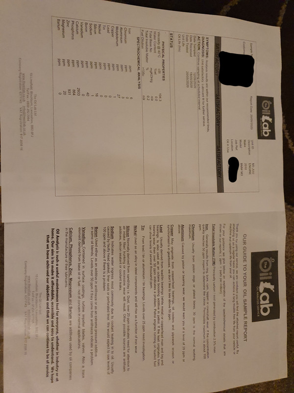

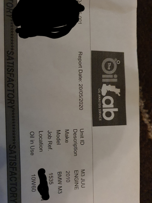

I used these 20200601 222842 — Postimages]
[/url]

Would thickened oil show through oil full of metal from bearing failure?
I will get a sample of it and the filter this weekend.
