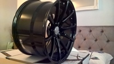

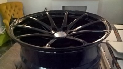

Well I ordered these on the 1st November and was told ETA end of Jan... and yet to my surprise they have arrived today!!! Concave Christmas..
thumbnail_WP_20191219_15_35_45_Pro.jpg thumbnail_WP_20191219_15_36_01_Pro.jpg

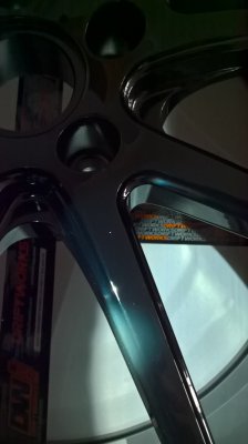

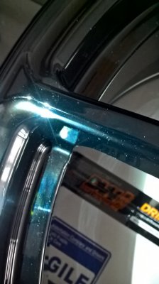

FFS!!, 2 steps forward, and 3 back again... the coating of the wheels hasn't gone to plan..
My plan was to start coating them today, 1 wheel at a time, set up my work area, got my inspection torch out to use while applying the coating, upon doing so I checked the wheels before doing anything and found loads of micro scratches on all the wheel faces!! Not Good, so I've had to send some pics and an email to the supplier asking them for some compo or part refund so I can have them re finished by a local powder coaters.... View attachment 91109 thumbnail_WP_20191229_11_36_54_Pro.jpg View attachment 91109 View attachment 91109 thumbnail_WP_20191229_11_36_54_Pro.jpg View attachment 91109 thumbnail_WP_20191229_11_36_54_Pro.jpg thumbnail_WP_20191229_11_37_05_Pro.jpg

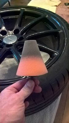

So… Now switched to Carbon Collective platinum wheels

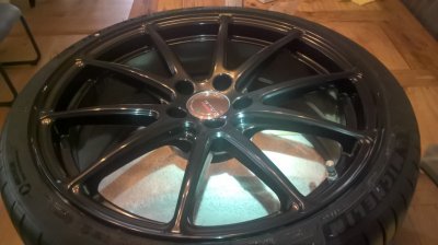

The 1st Job was to fully remove the KKD with a compound polish, I did this with a Polishing Cone in a drill, and some Scholl S20 Black.
Now that 1 wheel was completed with all the polishing, I was so Impressed by the finish that I decided to spend the next few hours doing the other 3 wheels... thumbnail_WP_20200115_10_10_56_Pro.jpg
Next up
Now all the polishing is complete, A full paint prep is needed prior to coating, I did this using Carpro Eraser and some Edgeless 70/30 Microfibre cloths from In 2 Detailing and cleaned each wheel twice to make sure all the polish residue was removed.
Next Up.
The Fun part. The product comes in a 15ml bottle with 1 small finger sized applicator.
I then set about applying the product to the inside of the spokes only, and worked my way around the wheel, allowed 2 mins for the product to start curing and then gently levelled the product with another 70/30 Microfibre buffing cloth. Note Do Not Buff this product hard as it will remove too much, you simply need to level the product to remove any high spots or smearing.
Now that the inner spokes had been done, I did the faces of the wheels with the very same technique as before.
Then Left the wheels for 2 Hrs before applying a second coat to ensure full coverage and durability.
Overall my experience with this product has been fantastic. I have used C5 in the past but wasn't that impressed with, I have heard that both Carbon Collective and C5 are made by the same company, however, if this was the case the application process would be the same but in fact its not as C5 is only recommended to have 1 coat as a second coat wont bond to itself.
For those of you who have yet to use this product, its really simply to apply with plenty of working time, as for durability They claim 2/3yrs, however if I manage to get half that I will be extremely happy as the product is less than £20.
Now wheels are finished including the centre caps..
