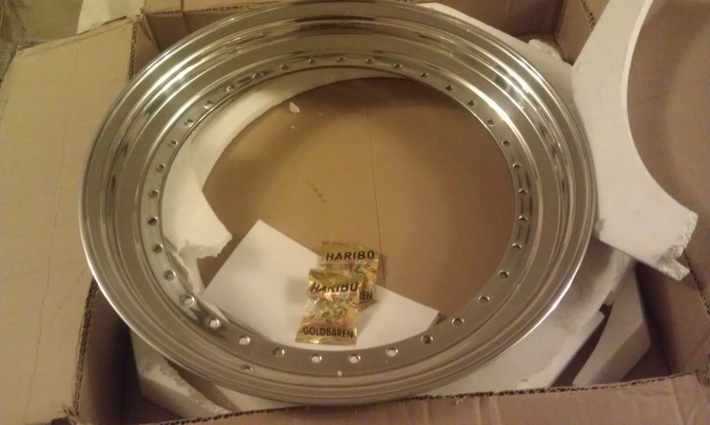

One of the dishes wasn't looking too hot, had taken a good thump at some point and then been reshaped with a lump hammer.
So this arrived this morning from the Fatherland...including a couple of packets of sweeties as a thank you!
Problem is, seeing this I'm now tempted to get the other 3 polished up rather than painting, even though I know they'll be a PITA to keep shiny.

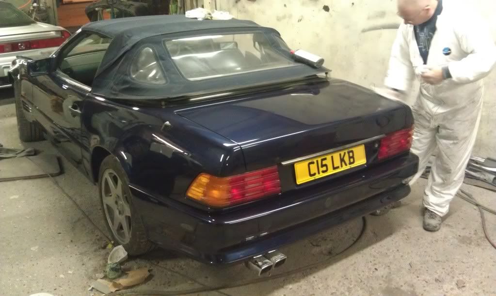

Not seen it myself, but my friend popped down to the garage today as he needs some paint on his Scooby P1.
Apparently it's painted but now needs the final polishing.

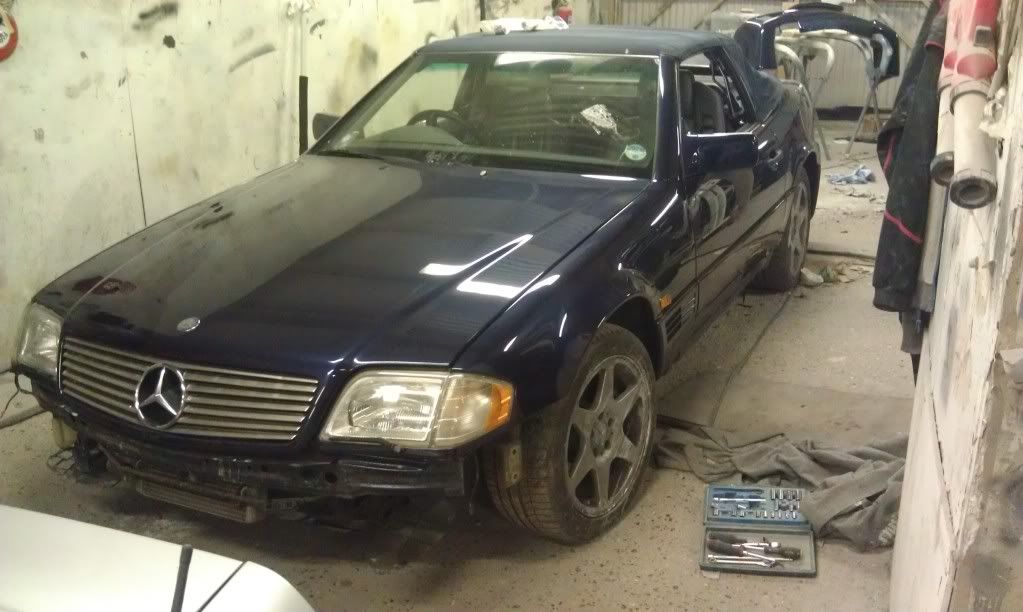

Saw the car tonight. The rear bumper is on, front bumper and side skirts are ready to go on. The ducktail needs a bit of a tweak to get the curve right to match the bootlid.
Hardtop is done and needs polishing up, the wheel centres have been primed and flatted ready for spraying along with a couple of little trim pieces.
