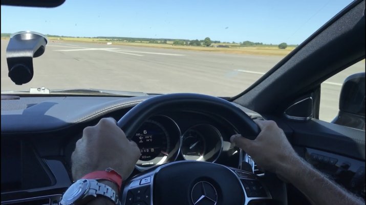

The chaps at MSL told me that once it's been mapped & de-restricted it would pull pass the PP 186mph & keep pulling until it "revs out"....not sure I want to test this, all I know is that i've had mine @ 160mph+ (on a private runway I have to add) & it was showing no signs of running out of puff..
Interesting. Pretty sure a mapped car will do >200mph, but never seen anything about vmax on a standard 5.5... Guess it must be close to 200mph as @AMGeed also reasoned!
