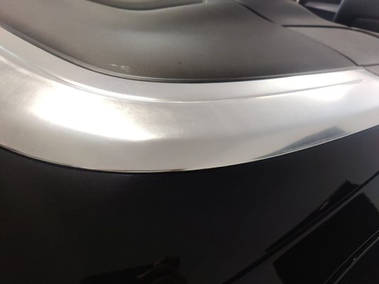

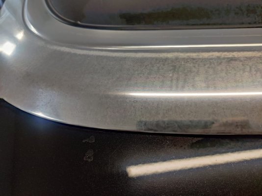

managed to remove the unsightly markings from chrome trim.
Used 1000 >2000 > 3000 grit wet and dry sanding discs, used by hand not machine, plenty of water and keep going in stages till the milky residue stops coming off, once happy with finish, go over with G10 compound, machine polish used black soft pad then buffing pad.
Still got to do the sides, takes a long time but result was near perfect.
