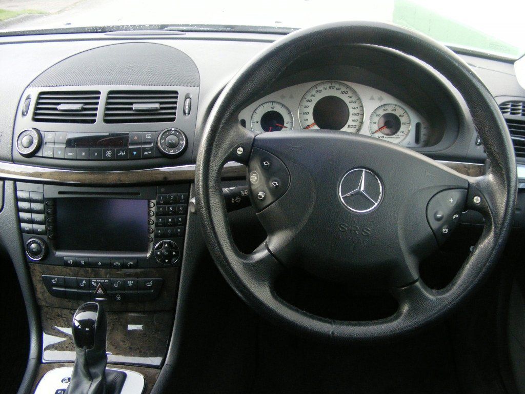

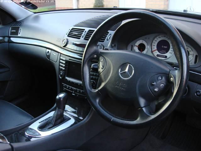

Pre/Post Facelift
The best way to tell is where the speaker is in the middle of the dashboard; if it's mesh then it's the 'updated' electrics and if the grille is slatted then it's the earlier one with a slightly higher probability of 'gremlins'.
Facelifts also have 805 or 806 on the data card. The rad issue is also gone on the later ones. Also makes some of the upgrades easier. These start at late 04` onwards, but don’t always assume as there are 2005 05 plates with an 804 build.
Facelifts will also have 200mph speedos to replace the 160mph ones on the pre-facelift.
Pre-facelift
Facelift
