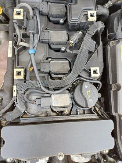

Felt the C180 wasn't running very smoothly and had an EML with cylinder misfire code. so decided to do a plug change and check the cam magnet plugs for leaks while I was in there.
Tools needed, An E8 Torx socket, long reach 16mm spark plug socket, decent socket set, electrical spray, copper grease clean cloths.

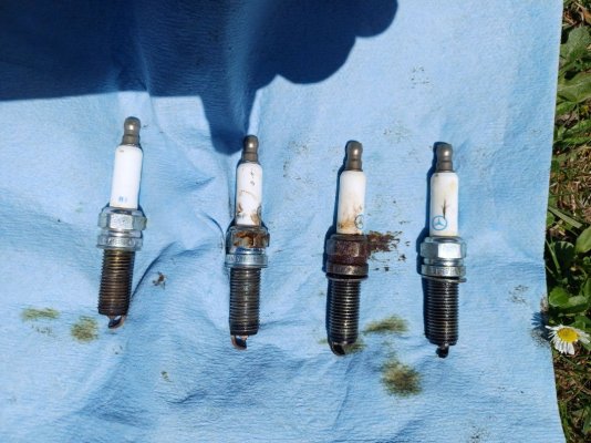

Took around an hour to do all 4 as some were extremely tight. The electrodes on cylinders 1~& 2 were nearly burnt away. No wonder it was running rough.
A small amound of oil had leaked into the plugs leading from the cam magnets but fortunately, the pig tail extensions I fitted stopped any oil wicking up the loom. I'll get a couple of new cam magnets and fit them shortly so when it does go up for sale in the next couple of months, it will have everything done to it including an oil/filter change and air filter.
A few photos of the work done and notice those electrodes in the two photos of the old plugs!
All the coil packs exposed #1 at the bottom by the oil filler cap.
#1 Coil pack removed
Look at that gap and the state of the electrode.
#2 removed and you can see the top of the plug
Looking down on Plug#3
Ready to drop in new #3 plug
#4 ready for new plug
4 very worn plugs.
Car runs very smoothly now, no hesitation at all. A job worth doing for around £50
