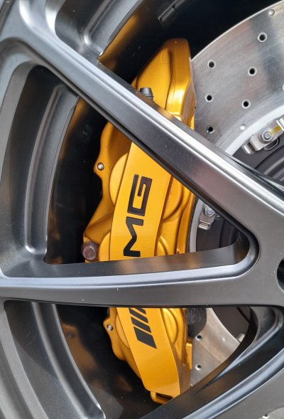

To upgrade them you only need to change the caliper mounts and discs only as the calipers are the same.
First up removing the calipers and discs, very simple job, with only 2 caliper bolts and the locating disc screw.

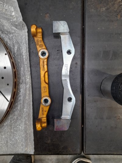

Once removed, you then need to remove the existing 360mm carrier and replace it with the 390mm.
Side by side, you can see the difference, these are available from MB directly or Epyteck.
Removing the old carrier is simply enough with some elbow grease, lots or groaning and sockets.
Once installed, a good clean around the hubs and behind the dust guard before fitting the new 390mm 2 piece Rotors.

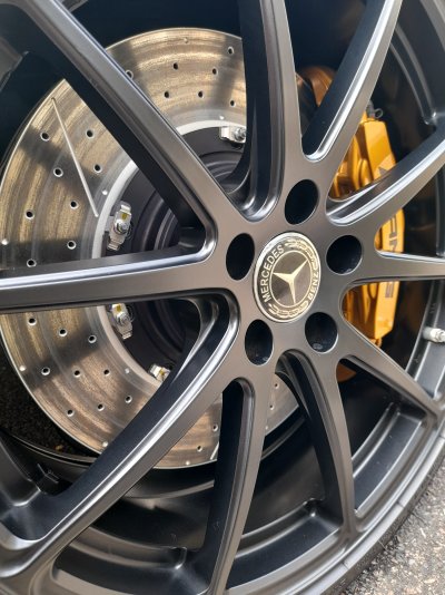

Fronts now complete, wheels back on.
Re fitting the wheel, checking for clearance of the balance weights..
The pic may not show, its only about 5mm of clearance between the weights and the wheel.
