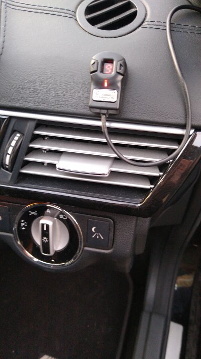

So the SB arrived today about 11:30. Fitted as instructions.
😳 It most definitely improves throttle response in R9 "race" mode lol. I haven't tried the lower numbers but on R9 in comfort setting on the transmission it has improved greatly.
I put the transmission in S+ mode with the R9, the highest setting available and yes again improves the response greatly. I haven't tried S mode with is Sport setting on the SB. So you get stock mode. S mode for Sport and R mode Race mode 1 to 9 settings. 1 being the least 9 being the highest, most responsive.
I put the transmission in M mode with the SB in R9 well the gear changes were very very sharp indeed, for me to sharp. I need to adjust the SB to see which works best with the transmission in Mode
I drive 80% of the time in C mode, with the SB in R9 the response of the throttle is perfect it really does improve the somewhat lazyish C mode shifting.
I've only had a 40 minutes trial with it. But on first thoughts it has really shapend C mode up. Really happy thus far.
More investigation to be done with what SB settings works best with S S+ and M mode.
Nice piece of kit 👍😁

Regarding the shifting, I think it's to do with the more responsive throttle. I say this because when in M mode previously no SB attached I could manually shift perfectly. With the increased throttle it will take time to adjust.
It has definitely made it quicker in C. Haven't tested it thoroughly, but it did seem to have an affect on the shifting in M mode. More than likely to do with the accelerator pedal. More investigation to be had on the M transmission mode.
C mode R9 is spot on 😁👍

For me, I find the MCT slightly lazy in C mode, the SB has eliminated that lazyness in C mode throughout rev range.
I don't like the car being in S S+ or M mode with town stop start driving, it's to egar Especially the dropping to 1st gear element.
With the SB in place in C mode it has brought the throttle response to life and like I said can still default to 2nd gear. I have found a massive improvement. Not for everyone. But I would recommend trying one, you can always send it back, if it's not for you!
