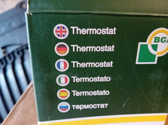

For educational purposes only... you never know when you might need the foreign for thermostat!

It's one of those wonderful words that you can even read in Cyrillic.

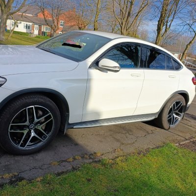

I do love new tyre day. Fitted a full set of Pirelli PZero (MO), with new TPMS sensors and four wheel alignment.
When driving home from the above wheel alignment last week, a message appeared in the cluster saying that suspension was returning to standard ride height.
It promoted me to think that this would probably explain why the camber was out and couldn’t be adjusted, as it had been set for driving in the ā€œhighā€ offroad or wading position.
It automatically drops down to standard ride height when you reach a threshold speed (maybe 30 mph) to improve stability, and then again at high speed (maybe 70 mph) for improved fuel efficiency.
I booked it back in to be checked and readjusted at the standard ride height. That was done today.
Turns out the guy who put it on the lift raised the ride height as most cars with air suspension require it, but the Mercedes doesn’t. The guy who did the alignment didn’t realise it was lifted. Easily done.
