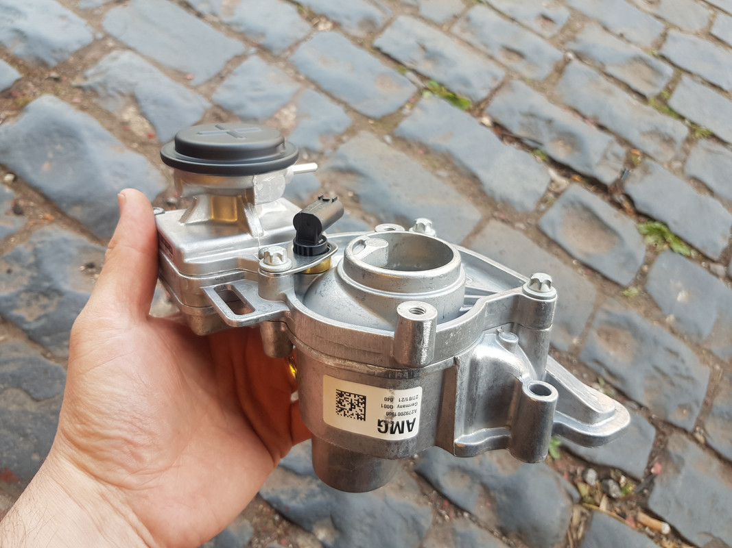

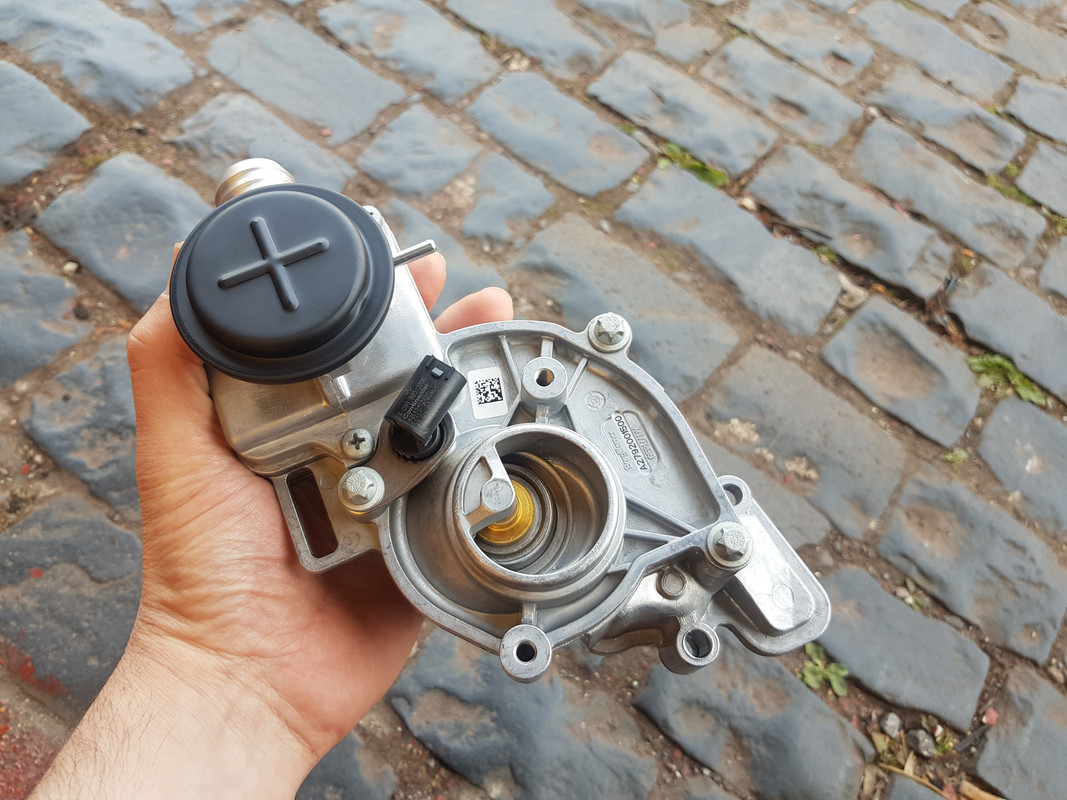

Quite an expensive thermostat but it does seem more complicated compare to an average car.
I was told I could leave the old thermostat as it was working fine and it was a one off that it got stuck but I didn't want to risk it.
New one....... I wonder why it says AMG?
![](https://i.postimg.cc/qBwMkfg2/20210423-145034.jpg)
![](https://i.postimg.cc/c4qyyXBf/20210423-144946.jpg)
![](https://i.postimg.cc/fRrfpgxN/20210423-144948.jpg)
Changing the thermostat in this car must be the easiest job you could do in this V12 engines. It takes no more than 10 - 15 mins for the whole job, it is that simple.
